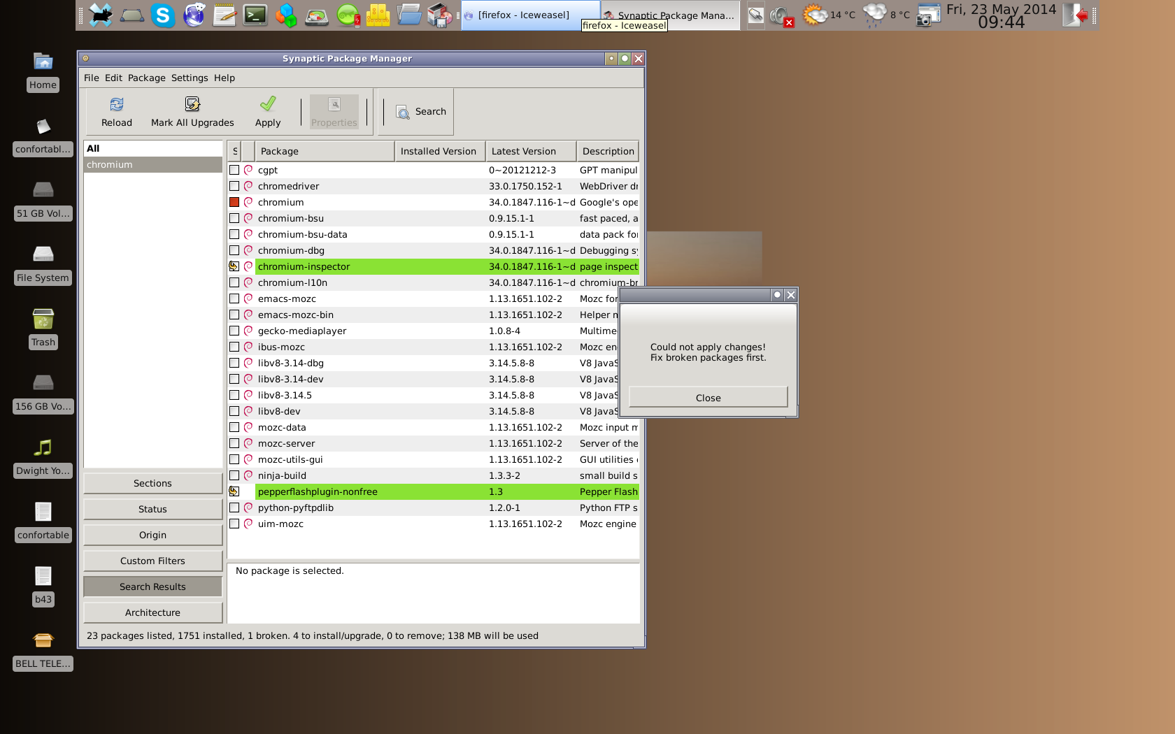

Bonjour les amis ,
je viens d’essayer d’installer le navigateur ( Chromium )… mais …
pix.mathieui.net/upload/original/1400849292.png
j’ai fait :
sudo apt-get -f install
sudo apt-get autoremove
Merci à l’avance de votre aide

ma console m’a dit mon problème :
chromium : Depends: libudev0 (>= 146) but it is not installable
E: Unable to correct problems, you have held broken packages.
mine@debian:~$ sudo apt-get install chromium
Reading package lists… Done
Building dependency tree
Reading state information… Done
Some packages could not be installed. This may mean that you have
requested an impossible situation or if you are using the unstable
distribution that some required packages have not yet been created
or been moved out of Incoming.
The following information may help to resolve the situation:
The following packages have unmet dependencies:
donc j’utilise ( the unstable distribution ) …
y a-t-il une solution sans installer la ( stable ) ? :slightly_smiling:
